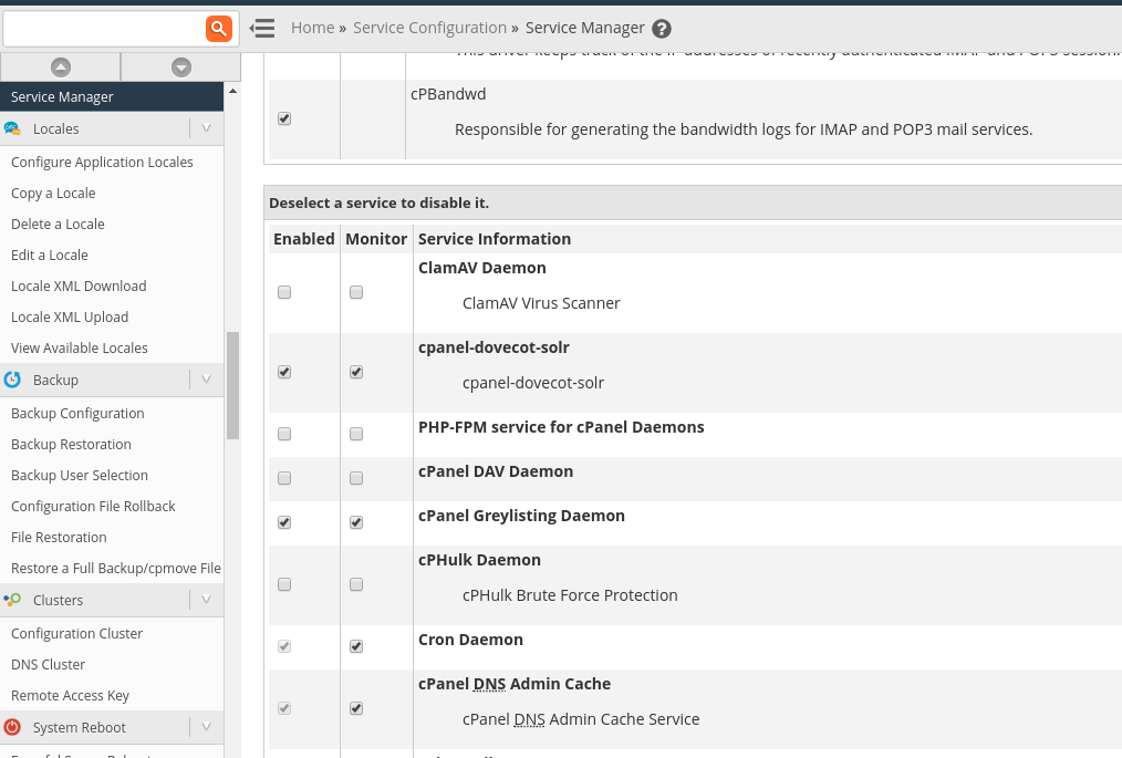

It can use up to 512mb of memory; if you don't need this -- you can disable it through WHM
Login to WHM > Click on Service Configuration > Service Manager
Under the second section; uncheck 'enabled' and 'monitor' for cpanel-dovecot-solr
I've attached a screenshot to help identify.

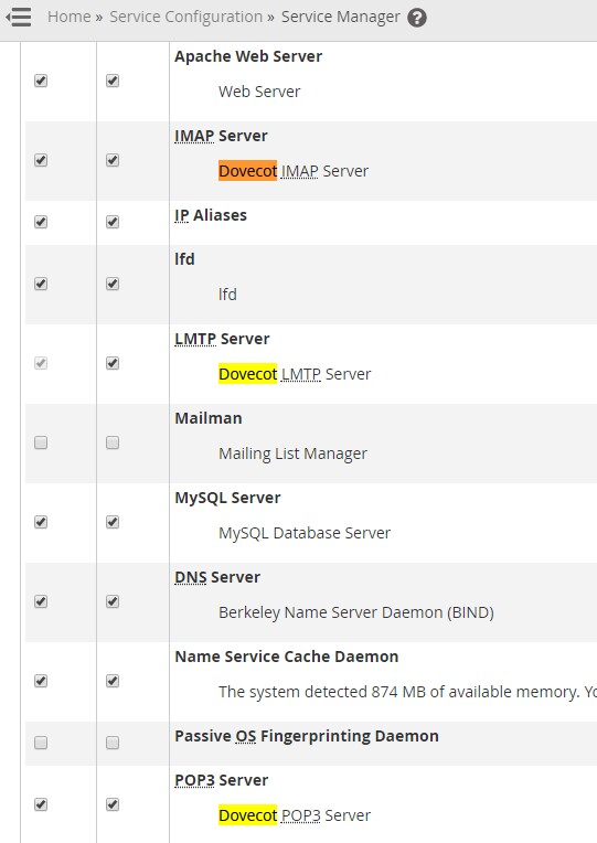

Weird, I don't have that anywhere, and some of what is in there is in a different order than that cap. WHM v68.0.25
Me neither :/
I only see Dovecot IMAP Server, Dovecot LMTP Server and Dovecot POP3 Server. All enabled.
In between I see Name Service Cache Daemon The system detected 874 MB of available memory. You should disable this service until the system has at least 1,000 MB of available memory. What is that?

Look for "Deselect a service to disable it." It is 2 below that on my CPanel.

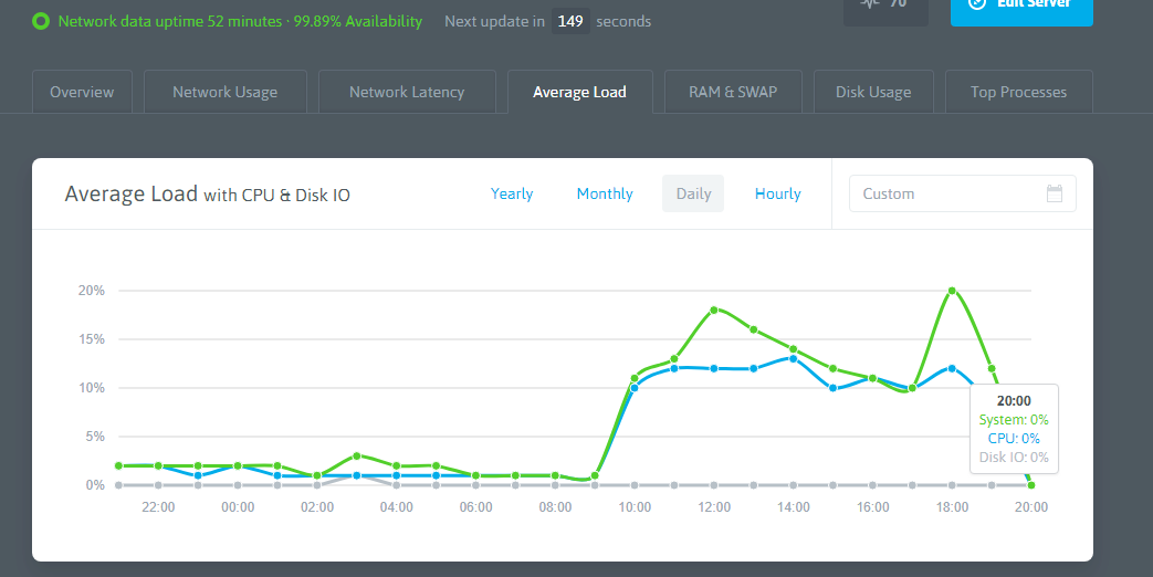

Alright made the switch to the MVPS-2 this morning. So far things seems a bit more responsive. I did notice that the server loads percentages are a little higher after the switch over. I'm assuming that's because the load is more concentrated to two full cores and not the percentage of the 16 shared cores?
Anyways, it seems to be running great with very low load averages.
Since those are percentage based and not load average the rise is definitely explained by the difference in cores. Looks like you still have plenty of headroom :)

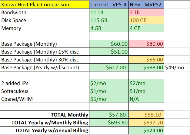

I'm still on my old VPS-4 plan and now have time to think about migrating to the new plan structure. I've read through the thread and there seems to be some confusion on migration costs, etc. so I decided to put together a quick spreadsheet that compares my current VPS-4 plan with what is the closest new plan which is the MVPS-2. If my calculations are correct in applying the discounts, etc. this seems to be only $0.30/mo difference for me on a monthly billing basis. One caveat: The $624 total at the bottom assumes the extra 10% discount for annual billing only applies to the base package. If the additional 10% also applies to the IPs and Softaculous that would alter the final amount slightly. Maybe this will help others who have not yet migrated to the new plan structure see how it would compare. I'm not too concerned about the b/w and disk space reductions, so if the performance is better it's certainly worth it.
